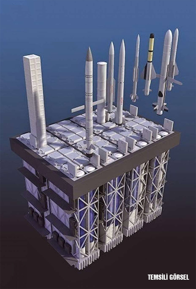

From the live interview. Kozan said that Korea is developing K-VLS with its own missiles, its identical to MK41 in shape and size. They wanted to integrate ESSM to it. US did allow but in the condition that it would not be quad-packed. My first comment was based on that.

For the Korea, they operate mixed VLS configuration on their ships(both K-VLS and Mk41), i haven't really heard if they were trying to put ESSM in K-VLS on those mixed ships (maybe it was happening for small vessels with limited number of VLS for example LST or such), they do carry their domestic missiles with K-VLS (K-ASROC, LACM, Anti-Air) and US missiles with Mk-41.
If it was working vice-versa they wouldn't really develop a VLS but integrate missiles to the Mk 41 and keep it common.
Integrating missiles into VLS is farther than just placing one or more canister within the Cell, VLS has a controller interface which mates with the missile and missile container's controller circuit or data port.

It would be stupid to make a VLS which does not have standardized dimensions. And with standardized dimensions it will be suitable for most of the missiles existing.

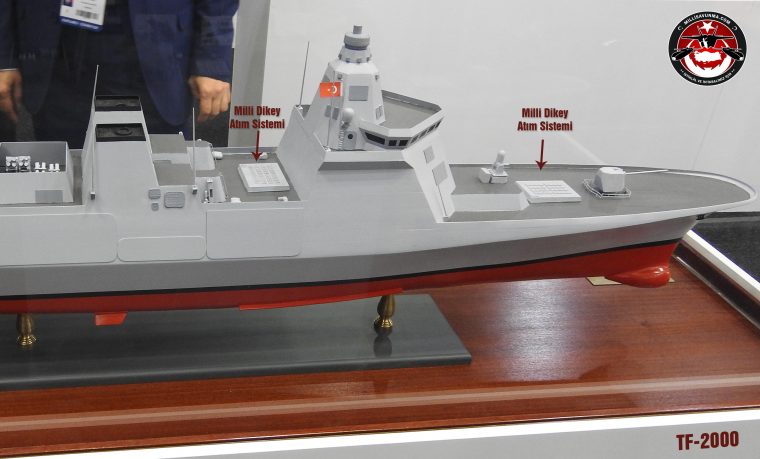

Aslında MDAS Projesi, bir dikey atım sisteminden çok daha fazlasını ifade ediyor. SavunmaSanayiST.com tarafından elde edilen bilgiye göre; Türkiye’nin, MDAS sistemine hiçbir yabancı füzenin entegre edilmemesi ve hiçbir yerli füzenin de Mk41 gibi yabancı atım sistemlerine entegre edilmemesi gibi bir tutumu var. Dolayısı ile Türkiye, TCG İSTANBUL Fırkateyni’nin envantere alınacağı 2020 tarihine kadar MDAS’da kullanılacak yerli füzeleri de üretmeyi amaçlıyor. Füze alanında hem Roketsan hem de TÜBİTAK-SAGE çalışmalar gerçekleştirmekte.
Milli Dikey Atım Sistemi, hem hava savunma füzelerini hem de satıhtan satha füzeleri ateşleme kabiliyetine sahip olacak. Yani GEZGİN Füzesi’nin de MDAS’tan atılması planlanıyor.
When you are in a “consortium” like this and are active in the development of the missile with a view to producing certain parts, you have access to most of the tech involved in the missile. That gives you a big head start. G40 is the fine example of this!
As we are producing our own missiles as well; Then it is only fair to think that anybody buying our MDAS should buy our missiles. Also any body buying our missiles should use our MDAS.
compatibility is required for integrating a missile with a VLS system and it is beyond fitting a missile physically. Can not happen without permission of the suppliers of the each system.
In simple terms (since it is how the procedures work analogically):
-You may have a printer which plugs into the computer (/OS) you have made, but the manufacturer does not supply drivers so you can plug it in, but you can not use it.
