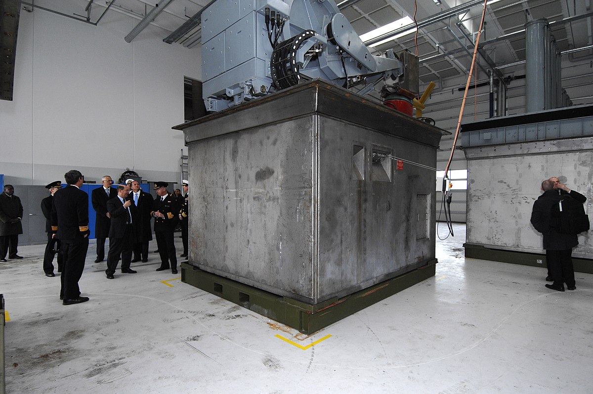

Russian Navy tested TOR on heli deck of Admiral Grigorovich

Built up on modules, making it easier to configure. And looking at how Multi-Role seems to be flavor of the year. We should consider whether it'll fit our doctrine. Indonesia went with Iver.
In fact those modules compromises the volume under the deck, you need to spare enough volume for several applications, even with the shallowest one (ie. SSM missiles) that volume is occupied, and thus useless. It is the cheaper way of providing modularity which results in inefficiency. I still don't understand why would someone strive for modular payloads on 5000+ tonnes frigate.
In Danish IH case there are 4 stanflex either to choose Harpoon in Mk141 (quad launcher) or ESSM in Mk56 (twelve launcher), which can be fit into VLS (8 cell = 32 ESSM) much more efficiently. So from efficiency point of view it is best used with 4 x 4 Harpoon which is already standard amount nowadays in frigates.
And i think VLS itself provides enough flexibility in the payload of the missiles.

I didn’t know the solution gave way to inefficiency. I was thinking they’d found solutions similar to building Lego, and each module could be refitted using highest possible efficiency without jeapordizing the overall structure with comparable tonnage and class
5,628
129 25,678
It still has deck penetration and support structure around the module (where it is plugged in)
I think it is best used when you need to use support modules like gun ,crane + rhib, ELINT - COMINT, Drone operation center. Not for interchangeable ESS - Harpoon - AD missiles.
You don't much worry about volume in large support vessels or OPVs which suits for this perfectly.
Most of the benefits also applies for similar non- modular equipment for naval vessels, if you have the spare one you fit it on vessel, take out the other equipment to the workshop.
