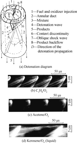

If you check the cylindrical annular chamber in below diagram you will see that the detonation waves for different fuels give different detonation wave structures.
In order to have continuous detonation wave there are certain limitations and rules with respect to detonation chamber size and height. For example, the radial size of the chamber should not be smaller than one detonation-cell size.

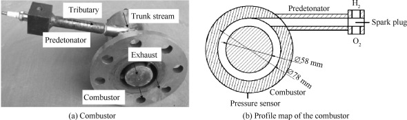

Here is the simple set up the Chinese scientists have carried out their tests with:
