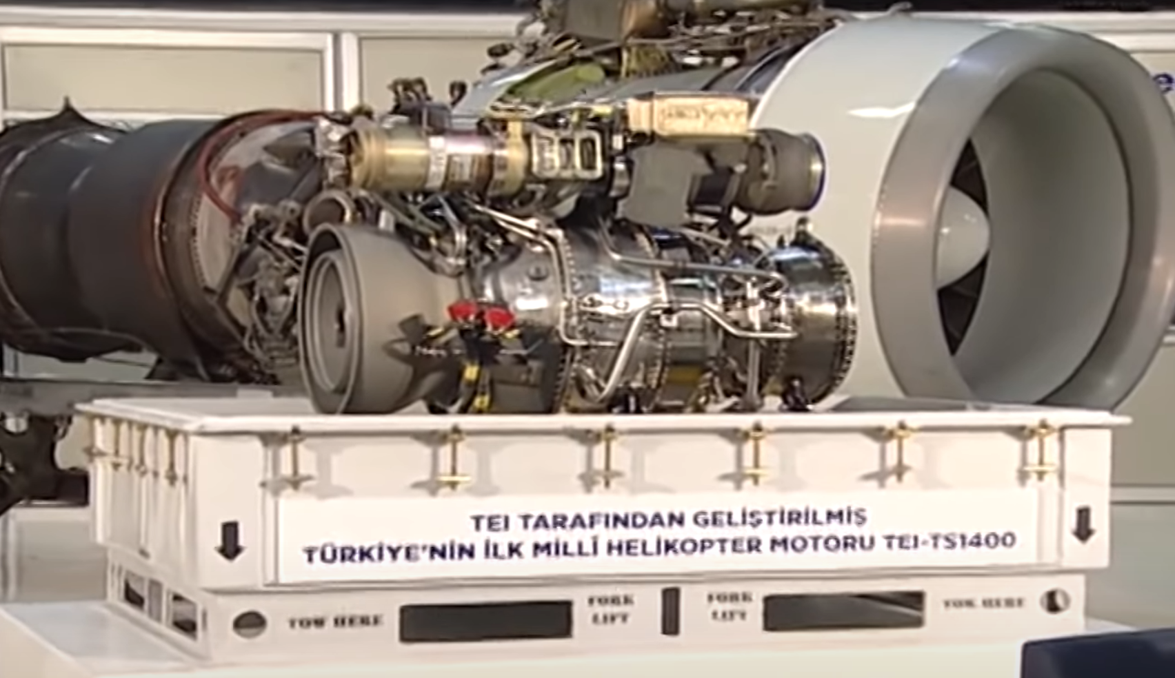

Good interview with TEI's Mahmut Aksit
TEI-TS1400
-1400shp continuous power
-1475shp take off power
-1600shp single engine emergency power, one of the last legs of the civil engine certification process
- 400 hours of testing completed so far

TEI-TS1400 is a good helicopter engine tbh
TEI really outdid themselves in this field; no wonder foreign engine companies are trying to disband any teams that TAI makes since if this trend continues then I expect wuch companies to run out of business in 20 years time
