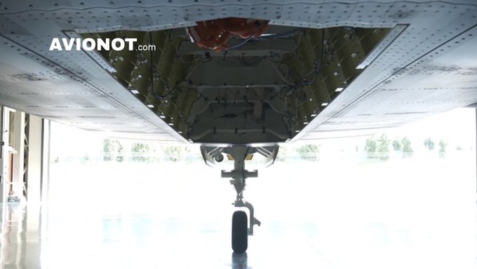

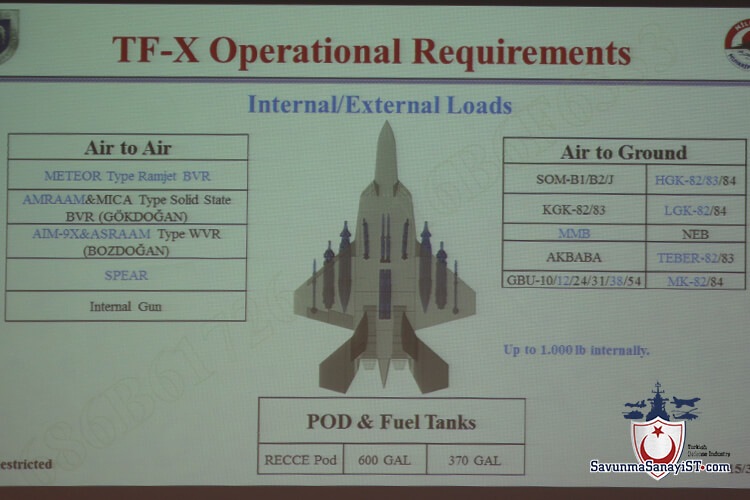

Well, no. TAI CEO explicitly stated total internal payload capacity of KAAN would be 10t, compared to 9.5t of F-22. Which seems reasonable given it's size. From that, at least 1000-1200kg would be for internal weapons. I mean it would be ludacris to assume KAAN won't be able to carry at least 4 BVR missile (in the main weapon bay) and 2 WVR missile (in side bays). That along would weight more than 800kg.
I heard from someone I trust that KAAN side internal weapons bays will be able to carry Gökhan ramjet missiles. Same person told me side bays can carry weapons shorter than 4m with a weight of around 200kg.
Here, the discussion ends. There is no need to discuss further as it has been proven that A-K/2021-2 presentation is outdated to some extent and not a reliable source for your claims
Just a tip, don't be too fixated
It is not outdated. It is the requirement set by the Airforce. It is like a baseline. No one is stopping TAI from delivering a better product.

Even your article is outdated. Your article was published in May, 2021 and Turkish Airforce presented the overview of TF-X program in June, 2021. So much for

KAAN will be able to carry maximum of 1000lb of ammunition each, rather than a total of 1000lb, in its main IWB. And as @TheInsider mentioned above, there will be Bozdoğan WVR missiles in the side weapon stations on the both sides. (Anatolian Eagle-21/TurAF presentation, June 30, 2021)
*As @infrared mentioned, SOM-M is probably the MMU (National Combat Aircraft) version of SOM-J (JSF),and according to a report from 2021, size and weight optimization studies were carried out on SOM-J are known. Most likely it was called SOM-M.
That sounds obvious, why else design a missile like that, if it can't fit only place it is supposed to 😁
Gökhan ramjet missiles in side internal weapons bays doesnt sound obvious but rather unprecedented and a big question mark.... it is not just about the dimensions or the weight capacity of the side bays.... this claim may even implies a different approach and a doctrine
Yes and note that the Bozdoğan WVR missile is already 3.3 meters long and weighs 140 kg with a diameter of 160mm. In comparison, AIM-9x is 3 meters long, weighs 84kg, and has a diameter of 127mm.
Very interesting claim indeed! it is almost common knowledge that unlike F 35, F 22 is build around its internal bays, the very existance of side bays on F 22 is because they didnt want to waste the valuabe space of the main internal bay with WVR and side bays are their engeniring solution for WVR.... KAAN will have WVR this is a fact and as stated Bozdoğan has its advantages but weight and dimensions are the cons in some ways. Million dollar question is if you already need relativly bigger space with relativly big weight capacity for bozdağan would you build your side bays even bigger to accommodate your future missiles like Gokhan I speculate at certain point some may think about it but I still think side bays will be kept for WVR Bozdağan since the limitations and math dictated by internal bays is there for Kaan just like F 22 but sure open to nice intersting suprises since Kaan is unipue :devilish:
