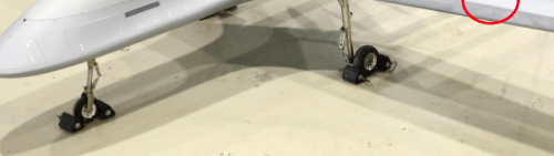

Short summary for naval landings It should have diffrent gears but for land duty those gears are sufficent.
I like baykar but they are not a god like entity I can criticize them.
You do realize that this is the first prototype and might not even actually be used on Anadolu?

Does this look strong? this is probably for land variant naval version should have much stronger ones.
Nutuk you could just say this is for testing and land version but you went to say stuff like that really shows your age lol
Also a quick observation whenever we criticize something in this forum people tend to say stuff like "ARE YOU AN ENGINEER?" "GO MAKE A BETTER ONE IF YOU CAN"
this is a free speech platform we can criticize stuff.
Heavier the airframe is, the sturdier the landing gear will be. I don't know what you were expecting to be honest. TB3 will be slightly heavier than the TB2 (which itself is light as heck). You don't need the landing gear configuration of an F/A-18 on this thing.

You can of course criticise them, just as people can criticise your criticism for being misguided and ignorant.
Doesn't short landings cause much more stress to the landing gear?
Of course they do. That's the reason why the R&D team changed the landing gear configuration to begin with. It would've been more economical to use the landing gears from the TB2 instead, but that's not what Baykar did.
They still need to conduct some studies to assure those gears will withstand the worst conditions on a ship. I think for prototype tests they assume typical landing conditions on a land strip.
There is yet to come shore based ski-jump tests and arrest system tests on the land before trying it on Anadolu, in a calm sea and then desired sea state. Yes Navy has a habit of demanding demonstration on adverse weather conditions.
Sure you do have full right to criticize anything.
But I noticed you are not making critics but claims (out of the blue without any source or professional credibility). There are too many guys like you putting up claims without any credible backup
Simple dynamics of rigid bodies question for fresh engineering graduates;
a TB3 enters ski-jump %10 below the take-off speed and continues to accelerate with %5 of the take off speed (per second), given the curve of skip-jump (refer to any TCG Anadolu images, side-views and fit a 3rd degree polynomial) obtain the maximum force exerts on the front wheel in terms of the G (gravity). Assume mass as given by Baykar, CoG is positioned in midst of the fuselage and mass moment of inertia, angular motion is negligible. Ignore platform motion and unsteady weather conditions, assume a steady motion as given. For simplicity consider take-off speed as service speed.

Yes. And there is nothing wrong with the landing gears. It doesn't look like that but TB3 is actually very light with a 1450 (1500) kg MTOW for comparison Anka has an MTOW of over 1700kg. TB3 will be able to carry a payload of 280kg(Anka carries 350kg comparison). The typical load for TB3 might be 2x Kuzgun+2xKayı-50(50kg) or 2x Kuzgun+4x MAM-L.
TB3 can produce a big lift force at a slow speed that enables it to take off from short distances and when landing, landing gears and body withstands less force but it is still 35knot faster than TB2 due to stronger engines. Geometry is optimized in that regard.

When I first saw this picture I thought;
Wow they have done their homework right;
As well as two things that were very noticeable:
1. Aerodynamic body and a possible high lift potential
2. Really robust looking, improved landing gears.
There should be no problem with take off from a ski lift with the TEI engine. However it would be interesting to see how they are going to stop this bird after landing. Especially if the plane has to avoid the large lift at the aft of the ship.
In any case this bird looks like an improved next generation of a tactical TB2 drone. Well done Baykar.
