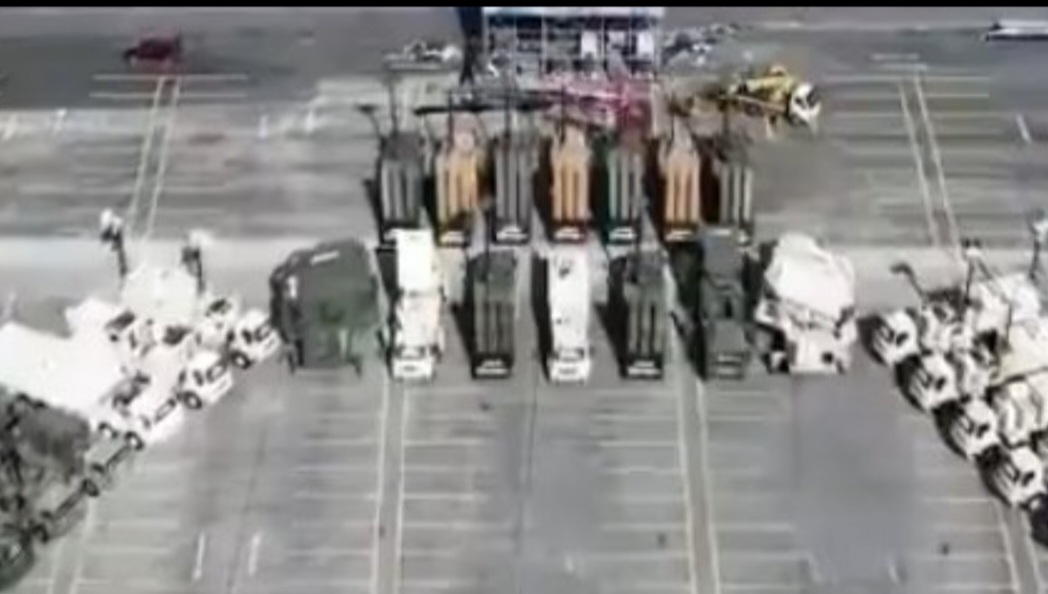

📡🎯 100% SUCCESS FROM THE NEW ACTOR IN AIR DEFENCE!
💯 The #MKE #TOLGA SHORAD firing test observed live by nearly 100 high-level participants from the Turkish Armed Forces and various security units were completed with 100% success.
🛡️ The MKE TOLGA Short-Range Air Defence System is designed to counter the rising threats of mini/micro UAVs, tactical drones, smart munitions, and cruise missiles on today’s battlefield.
⚔️ With MKE Tolga Ammunition specially developed for the weapons integrated into the system and programmed to detonate near the target and disperse fragments and with every component produced by MKE, the MKE TOLGA SHORAD offers a complete system solution.
It combines electronic warfare, anti-drone ammunition, weapons of various calibres, and a command and control system that brings detection, tracking, and neutralisation capabilities under one roof:
📡 Up to 10,000 metres with a mobile radar station capable of tracking and surveillance, electro-optical system, and jammer
♦️ 3,000 metres with the 35 mm Tolga Weapon System
♦️ 1,000 metres with the 20 mm Tolga Weapon System
♦️ 300 metres with the 12.7 mm Tolga Weapon Systems
Together, these provide effective protection by neutralising hostile drones and aerial threats.
#TheRisingPowerMKE 🦾🚀🌍
Fucking hell, recoil and spread was insane in some of those shots, thank god they use airburst rounds. And in most of the shots drones looked stationary, I would love to see this system tested against drones that are actively trying to avoid getting shot at full speed.
Did they use airburst ammunition the 50cal looked like delayed open (fuze) with small pellets inside that open after it left the barrel.
The 20mm was airburst or at least proxy fuze.
boredaf
2,316
42 6,815
It should be airburst, most likely delayed fuse though. Las year or this summer Aselsan and another company had revealed 7.62 and 12.7 mm anti-drone ammo, so, it should be either that or something like that.
