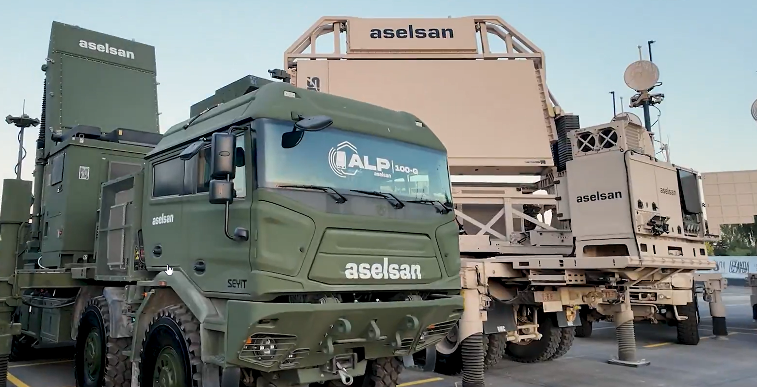

What does Autonomous mean?
I think it just means it's not a theater level engagement of the battery but unit level one. We also can't see the search radar(ALP-300G); only the fire control radar(Akrep-1000G) on the video. It's a test of a "blinded" Siper battery without access to its search radar's or of any other systems in the Steel Dome picture.
It has nothing to do with AI features.

So, it’s a standalone unit cut off from network working in full automation (human still in the loop), right?

So let me try to understand this and translate it for us mere mortals:
There was no search radar present with the unit. It received search data from elsewhere. It was manually fired and fire control radar and/or its onboard seeker guided it to target.
That shouldn’t work. It has to receive data from a search radar regrading the presence and position of target. It is not cut off from network. On the contrary. It is connected. But not sending signals to protect its position from being discovered.
At least that is what I understand from @Sanchez ’s explanation . Please correct me if I am wrong.

I think AKREP-1000G can perform both search and track in emergency situation (where primary search radar is out of commission) as it is in principle a Multi-function AESA array.
This test was meant to demonstrate that.
Atleast this is what I understood from @Sanchez 'blinded' unit level engagement comment.
Indeed, Akrep-1000G is multifunction radar capable of undertaking search duties as well:
"AKREP 1000-G is a radar system developed with Active Electronically Scanned Array (AESA) architecture, capable of both rotating and stationary operation, performing search and precision tracking functions."

Think of Hisar A+ Otonom, it's also designed to be able to work by itself, not as part of the whole architecture. There's nothing "autonomous" as in unmanned about it, except for being a system that can undertake all its mission set by itself. Word here mean something like "All-in-One", not unmanned. Like Spyder AiO.
Another example would be Korkut. A "Korkut System" is 3 fires vehicles and a command vehicle. But each fires vehicle can also work autonomously by themselves utilizing stricter search functions like their tracking radar and EO systems, without the MAR search radar on the command vehicle.
