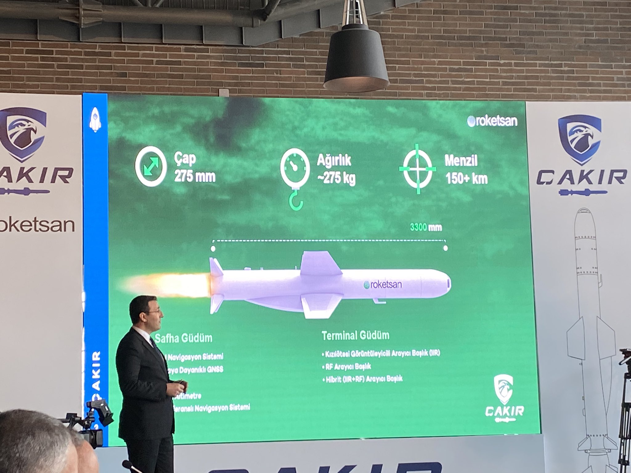

275 mm diameter
330 cm length (without booster)
275 kg launching weight
150+ Km range

Is it a Surface to air missile? And if so, what are its specs?
It is not a surface to air missile. It is primarily an air to surface and surface to surface missile developed to be deployed from unmanned air vehicles (UAVs), helicopters, fighter planes and surface positions with a range of 150+km. it is a low sea skimming missile that will have swarm attack capability. As well as hitting sea targets it will have capability to hit coastal land positions too.
