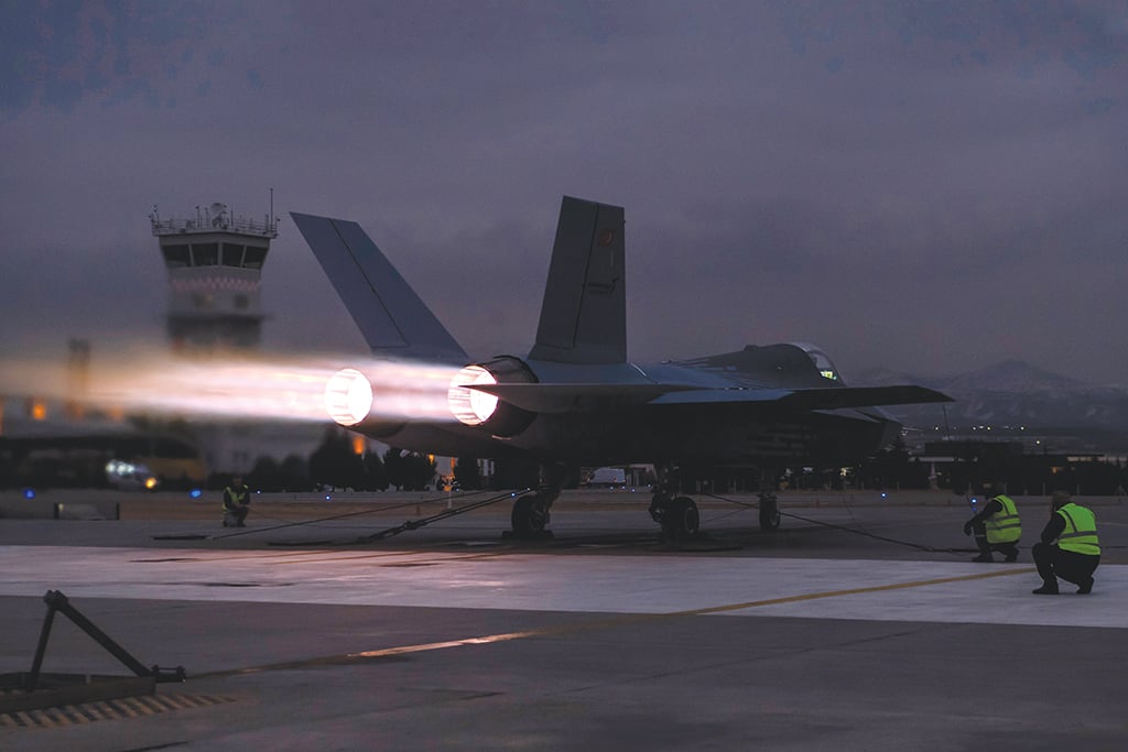

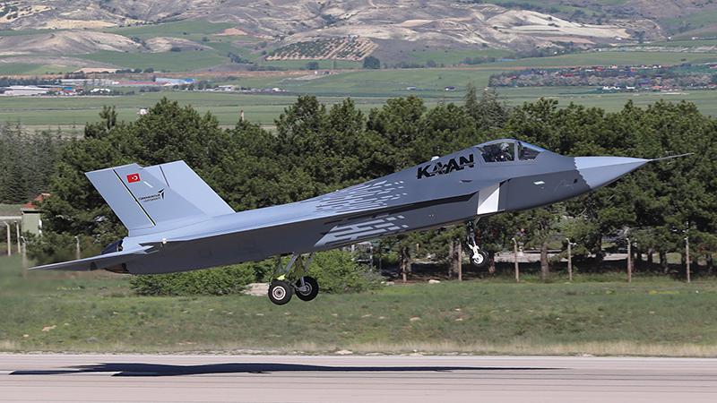

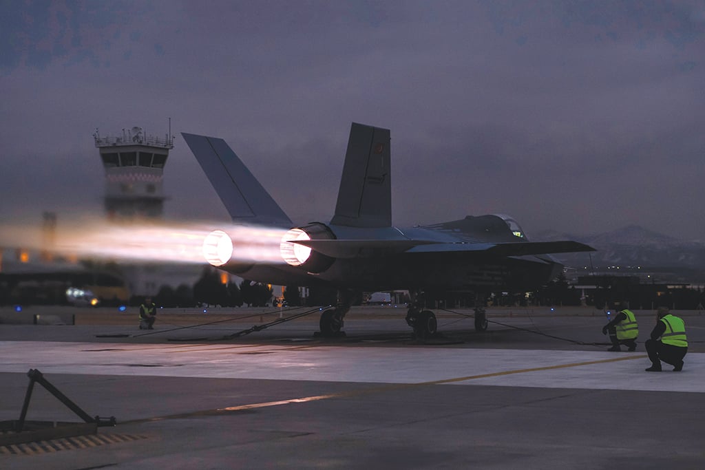

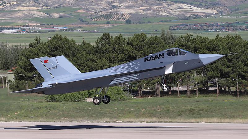

Turkey’s Kaan Fighter Development Gains Momentum
Source: Aviation Week
https://search.app/ZNY7S
Shared via the Google App
View attachment 74793 View attachment 74794
Work is also continuing on an indigenous power and propulsion system for the aircraft; TAI-owned companies TRMotor and TUSAS (Turkish for TAI) Engine Industries (TEI) are handling development. The P0 aircraft, the other prototypes and likely the initial batch of 20 aircraft destined for the Turkish Air Force will be powered by the General Electric F110 engine from the F-16, but Ankara is funding the development of an indigenous engine to make the aircraft as free as possible from U.S. International Traffic in Arms Regulations rules. This would give the country a free reign when it comes to exporting the platform.
A preliminary design review of the engine is planned for the end of this year, Demiroglu says. The company aims to install a flying prototype by 2029. He suggests initial flight trials could take place in a Kaan with an F110 on one side and the indigenous engine installed in the other.
The goal is to make an engine that could essentially drop into the same position as the F110 but achieve higher levels of thrust. TRMotor has developed an auxiliary power unit for the Kaan, and TEI is leading the design of the engine.
