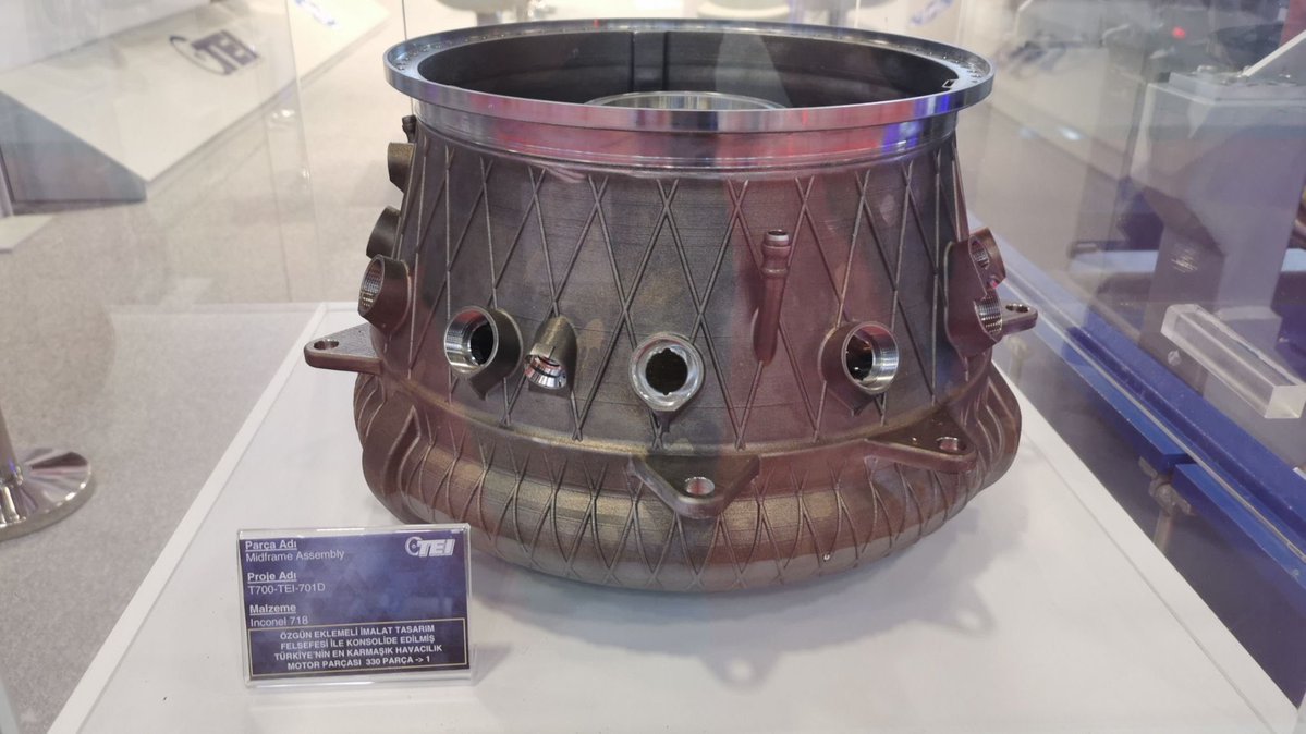

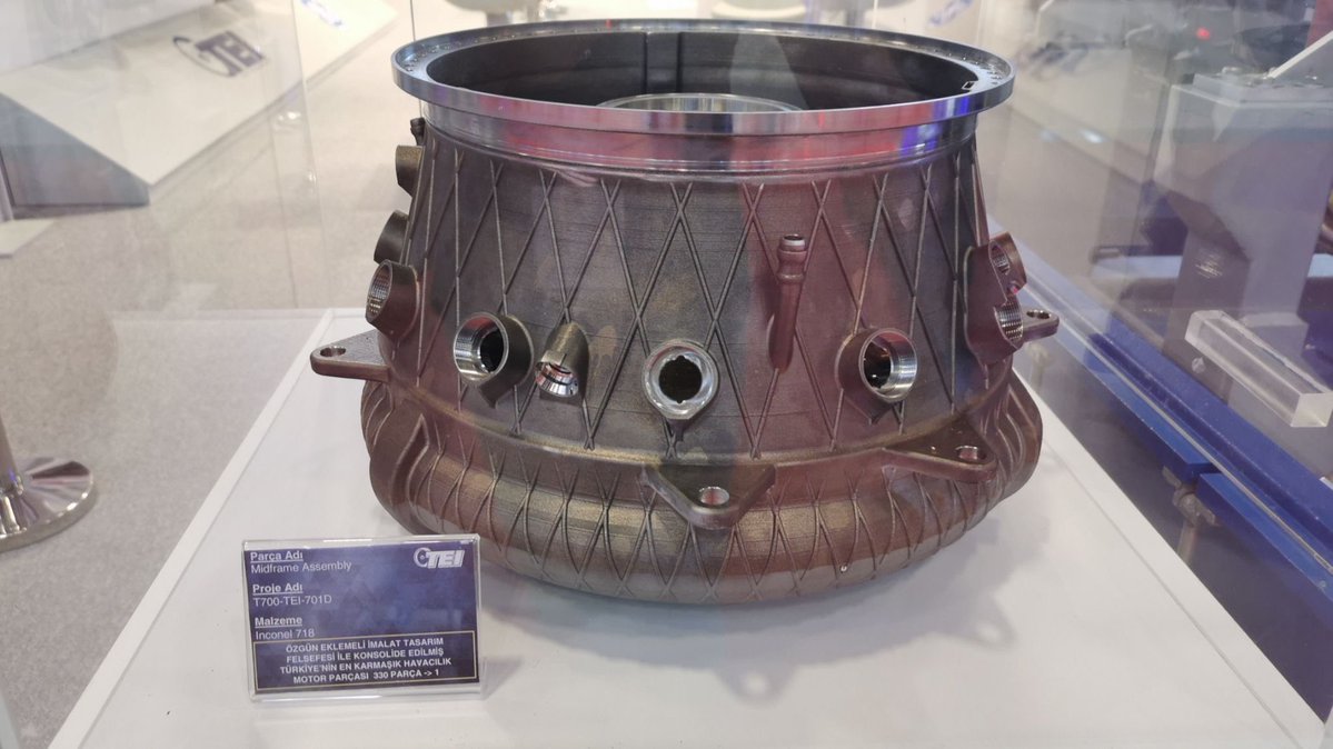

Very good interview with Prof Aksit.
He explains about the mid section of the 2000shp T700 engine. How TEI engineers managed to produce a 300+ piece mid section unit with a 3D printer as a single piece. This in it’s own right is a groundbreaking technological advancement of Turkish turbine engine building. Current Turkish T700 helicopters are having their engines with this mid section.
@Lonewolf for your benefit: He once again reiterates that as TEI they can manufacture much larger engines. And that they know the difficulties that come with when manufacturing larger engines.
