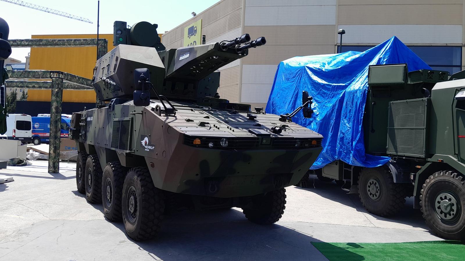

Roketsan Burç Short Range AD System. 4 fixed AESA radars, 20mm Gun, 8 Sungurs on 2 pods on the sides, built on top of FNSS İzci 8X8. And they already made the first firing test for the gun. Looks like another small UAV/kamikaze drone killer.

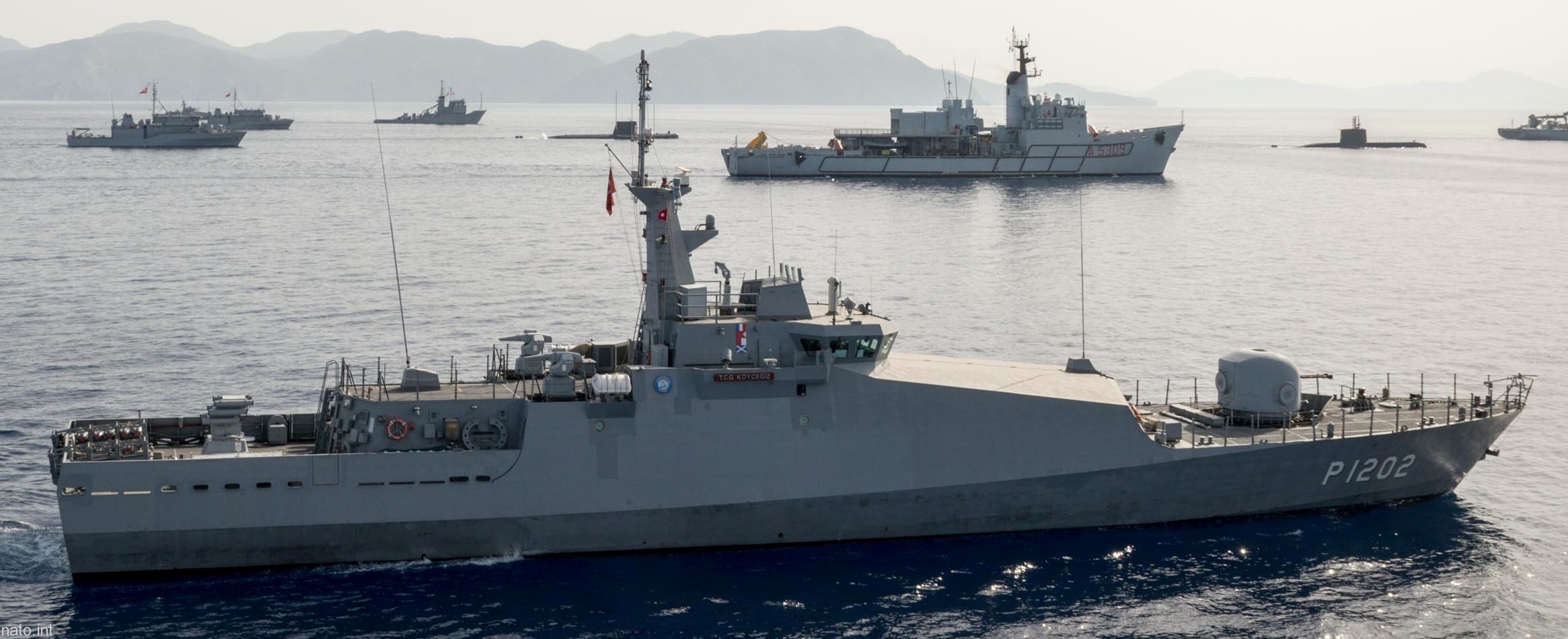

@UkroTurk
Thanks to UkroTürk üstad, when I see this type of pedestal-mounted or mini turret type low altitude defense system, now the first thing that comes to my mind is Tuzla patrol boats.
Got me thinking.
Digital camo on it very much resembles the current Ukrainian one. Ukraine would love such a system. Wonder if we will see it up north in the near future.
Main weapon - 8 Sungur Manpads
Maximum 8 km minimum 500m range
4 km altitude
Pre-fire lock-up mode
High explosive partial penetrating warhead
Automatic target tracking and IIR guidance
Auxiliary weapon - 20mm 3-barreled gun
360 degree turret swivel capability
Hemispherical radar coverage
Multi-platform integration
WTF. They went crazy. How many air defense systems are we going to see?
ZSU 23 Shilka is crying 😭😭😭 why i am outdated.
Burç will replace all Shilkas especially in the middle east.
IMO This vehicle needs some sort of Pulat/Akkor system.
It's one of those vehicles that'll get taken out because it's moving around a lot due to it's mobility and it's SRAD setup.
If we're going to look at where and how it's going to be used I'd say chances of running into someone with ATGM is quite high.
Aside from being quite versatile it could easily be used as pseudo IFV.
