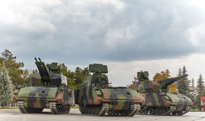

Your math is weird. The Control center(I assume what you want to say is, fire control vehicle) is already a part of modernized AAA batteries. It is not there because of a single Hisar-A+ launcher. So land forces opt to add a single Hisar-A+ truck-based launcher to the already existing infrastructure of modernized AAA batteries rather than creating separate Hisar-A+ batteries with 3x truck-based launchers. It will bring a good capability increase to AAA batteries without costing a lot. This way most of the Hisar-A+ orders are replaced with Hisar-O+ orders.
This is a Korkut Battery. Armored Hisar-A+ will also be a part of this. The difference between Korkut and modernized AAA is that every Korkut vehicle can act completely on its own as a single unit(İt has everything it needs to engage targets on the platform) without its fire control vehicle. This is also the same situation with armored Hisar-A+ and truck-based Hisar-A+. So Korkut and Armored Hisar-A+ are suitable for armored corps and modernized AAA and truck-based Hisar-A+ are suitable for base defense.
