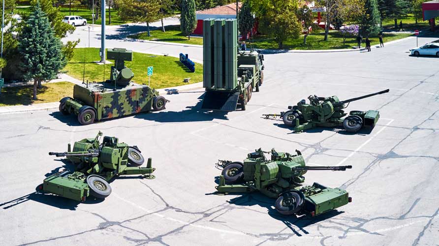

Orders of the armored version are massively cut but it will still be produced for armored corps. The truck version will be used with modernized AAA cannon batteries. 3x modernized AAA cannon 1x fire control vehicle and 1x Hisar-A+ truck version. So rather than having Hisar-A+ batteries with 3x truck-based launchers, land forces will have 3x modernized AAA cannons+ and a single Hisar-A+ launcher. So overall orders of the Hisar-A+ are cut but it will still be utilized. Hisar-A+ launcher pods on the truck can also be changed with Hisar-O+ launcher pods.

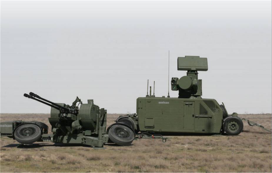

towed 35mm Oerlikon modernized by ASELSAN have the following features;
İnfact it is not just a modernization for 35mm Oerlikon , it creates a combined structure for 35mm Oerlikon&HİSAR A+
-The 35mm cannons are now able to fire airburst ammunition produced by Aselsan.
-modernized 35mm air defense gun system can be controlled without any human intervention thanks to the use of a Firing and Command Control System
-The Fire and Command Control System will undertake the mission of command control of the air defense gun systems and short range missile systems i.e HİSAR A+
-The system will have 3D search radar.
-fire control radar.
-electro-optical (E/O) sensors.
-threat evaluation, and weapon allocation capability.
-identify friend or foe and track the target by its own sub-systems.
this is a weird configuration and I don't recall any country use this method . but what's the point of it ? if they cut the numbers due to budget then it's not logical because it's more expensive . let's do some math :
( the main point that the control center is the most costly of all of them )
3 launcher per system = 1 control center .... 45 launcher delivered = 15 control center

Your math is weird. The Control center(I assume what you want to say is, fire control vehicle) is already a part of modernized AAA batteries. It is not there because of a single Hisar-A+ launcher. So land forces opt to add a single Hisar-A+ truck-based launcher to the already existing infrastructure of modernized AAA batteries rather than creating separate Hisar-A+ batteries with 3x truck-based launchers. It will bring a good capability increase to AAA batteries without costing a lot. This way most of the Hisar-A+ orders are replaced with Hisar-O+ orders.
This is a Korkut Battery. Armored Hisar-A+ will also be a part of this. The difference between Korkut and modernized AAA is that every Korkut vehicle can act completely on its own as a single unit(İt has everything it needs to engage targets on the platform) without its fire control vehicle. This is also the same situation with armored Hisar-A+ and truck-based Hisar-A+. So Korkut and Armored Hisar-A+ are suitable for armored corps and modernized AAA and truck-based Hisar-A+ are suitable for base defense.
