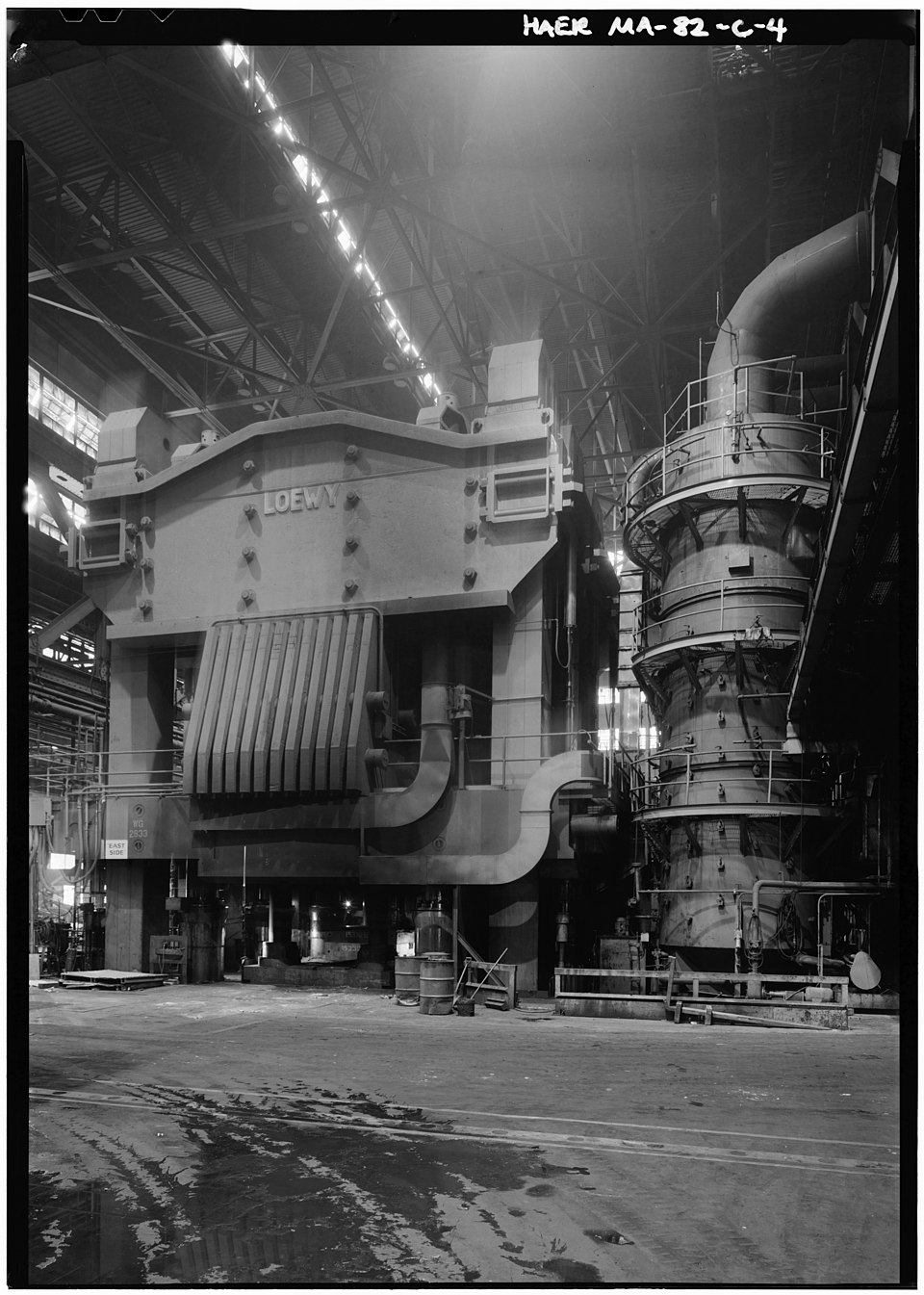

"Bulkheads", the upright wall within the fuselage of an airplane is either made with pressed/manufactured titanium or aluminium. Forge pressing capability of such alloys like Dr. Kotil said is a capability only few companies/countries have.
Currently one of the factories with such capability is companies like Alcoa and Howmet. These companies have capability to design presses etc., modelling and for metallurgy.
These images can give a idea how big and critic these structure parts are.
50 ton capable, 5 story tall forging presses build with years of design and metallurgy experience
As a such capability will not be available for MMU program and even if its for MMU prototype, getting MMU prototype parts under their production line is not an easy task. A lot of Civillian/Military aircraft programs are forced to use this limited resource (pressing machine etc.) to manufacture their parts.
One of the bottlenecks of MMU program I suspect was this. Capabilities in bulkhead pressing will change/limit aircraft size and performance.
5m x 7m titanium is a very big, to my knowledge there is no such system to manufacture a part like that under vacuum chamber.
It will be interesting how will this turn out while preserving particle quality and material size.
Similar approach was with TS1400 engine, TS1400 was designed in consideration with bottlenecks. Especially in areas where it is not easy to acquire parts. Because of this even the engine is stronger, it is being 20-30kg more heavier was foreseen during design phase.
I hope that the solution for the parts is found if not it has potential to deeply affect MMU program

I understand the simplicity and weight savings a single forged then milled piece can provide, but, I'm sure there are other ways around it. This forge didn't exist when F-22 was being developed - which is more comparable to our TFX project. How was the bulkheads for the F-22 produced, perhaps multiple pieces brought together ?
Schematic-of-F-22-aft-fuselage-assembly-showing-Ti-components-The-bulkhead-frames-and.jpg
10,926
152 22,265
Yes more limited production run of F-22 so less capital investment and RnD to achieve single piece.
The subcontractor was Wyman-Gordon.
Some useful examples (using 35k ton press rather than 50k ton one) can be found in the middle pages here:

It must be noted at the end there is a single piece bulkhead for F-22 as well (as has already been posted here)....so I am assuming there are various mid section parts regd multi-piece frames and single piece bulkheads.
So they already did have the capacity to do it for F-22
